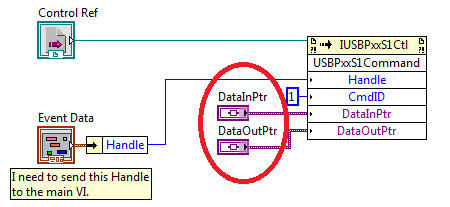

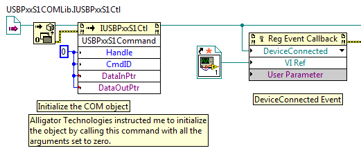

In the attached VI (AlligatorMain.vi), you may see that I tried to communicate with the device using “Reg Event Callback” to handle the ActiveX events. Basically, I need to get a “handle” from the connection, and use it in the Invoke Node to write/read some values from the USB device. I have a few problems, and I was wondering if you could help me with them.
1. As I run the VI, nothing happens inside the Callback VI ("AlligatorCallback.vi"). At first, I thought LabVIEW doesn’t register the events from the device, but when I looked at one of NI’s examples, the same situation exists. For instance, when I run “ActiveX Event Callback for Excel VI: labview\examples\comm\axevent.llb”, I can see everything goes as the description, but nothing happens inside the NewWorkbookCallback.vi. I don’t know how to access the data inside the event. How do I extract info about the event and use it in the main VI ((AlligatorMain.vi")?
2. The dll that I mentioned before has a command for controlling the parameters of the USB device. This command has four arguments (Handle, CmdID, DataInPtr, DataOutPtr). Handle is an integer that is for the device connection. CmdID is an integer to read/write a variable on the device (e.g. to read the value of LPFc, CmdID=1). DataInPtr and DataOutPtr are pointers to a structure (cluster) of data that contains all the variables of the USB device (e.g. LPF, Gain, etc.). Question: How do I read from pointers in LabVIEW?

See this thread: http://forums.ni.com/t5/LabVIEW/How-to-interaction-with-Main-VI-from-Net-event-callback
There are examples that show how to use a queue or a user event to pass data from a callback to the main VI. (Note that I posted the right images but the wrong VIs for the user event example; someone else posted corrected ones further down the thread.)
EDIT: Forgot to comment on the second half of your question. I have no idea how you would do anything with an input-only variant pointer. Is there any more documentation explaining what it's pointing at? Without knowing how much space should be allocated for the pointer, nor who is responsible for allocating it, I'm not sure what you can do.

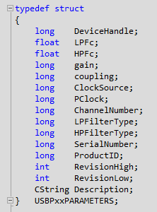

As for the variant pointer, I know it points to a data structure (written in C++) in the form of the following:
Message 3 of 22
(7,321 Views)
@Rooz wrote:
Hi Nathan,
Thank you very much for your help.  User Event and Event Structure seem very helpful.  I will try those.
From my reading of TestClientDIalog.h, Descritipn comes between ChannelNumber and LPFilterType.
Also, before you doing anything else, you need to send a CmdID of 0 to Initialize.
Message 4 of 22
(7,308 Views)
You could certainly try allocating memory for a struct of that size and passing a pointer to it to the ActiveX node, but I have no idea if it will work. I'm not sure that ActiveX calls share the same address space with their callers, nor how the Cstring parameter will work. I'd try allocating the Cstring as a pointer-sized integer but wouldn't be surprised if it causes your code to crash (save often). To allocate memory, use Call Library Function Node with the library name set to "LabVIEW" and the function set to DSNewPtr, which is described in the help and also in posts on this forum. If you need to pre-fill values into the allocated memory, then you should create a matching cluster and use MoveBlock. After the ActiveX call completes, use MoveBlock again to get the data into a format LabVIEW can use. There are examples of this on this forum, although they generally deal with a call to a DLL and not ActiveX.

The Description length in the structure which may be able to ibe implemented as a LabVIEW cluster appears to have a maximum length of 30 characters.
