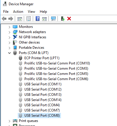

As Ravens Fan was saying this is a WINDOWS "feature" not a LabVIEW issue...
All you can do is manually clear the "ports in use"
In Windows Device Manager
  1. Under "View" check the "Show Hidden Devices" box
  2. In the Ports (COM & LPT) section you will now see every Com port that has been ever been assigned by Windows
  3. Right click on each one and select "Uninstall device"
  4. That will free up that Com Port number to be used again

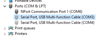

For some devices it may exist a registry key which will disable a new COM-port assignment for each device.
In a production environment where one has to constantly connect and disconnect USB serial ports or other USB devices (e.g. USB-memory sticks or disk drives) when testing a UUT the computer will fill up after a while, and if i remember correctly also getting slower. This can be seen in Device Manager by checking "Show hidden devices"  as shown by RTSLVU in his posting.
For my previous employer i made a wrapper around devcon.exe to both find assigned COMports and clean out old devices automatically. Unfortunately i do not have access to that code any more.
Information on how to download devcon.exe can be found here:
https://social.technet.microsoft.com/wiki/contents/articles/181.how-to-manage-device-drivers-with-co...
I just extracted the SDK and located devcon in these locations on my windows computer, these files can be placed wherever you want and run standalone (as long as you adhere to the licence.)
C:\Program files (x86)\Windows Kits\10\Tools\x64\devcon.exe
C:\Program files (x86)\Windows Kits\10\Tools\x86\devcon.exe
