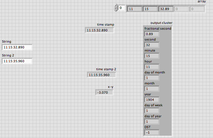

Look at the String and Timing palettes. The Date/Time to Seconds functions will convert separate numerical components into a timestamp. Spreadsheet String to Array (with : as separator) and Index Array gets you the components.
There are several other ways as well. Scan from String can probably be used.
Lynn
