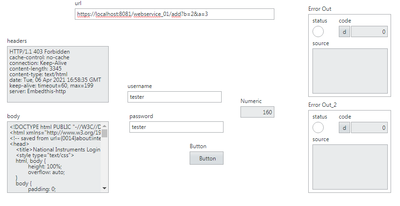

i am trying to call the simple "add" webservice make with LV2020 c.e. with a WebVi written with NXG5.1.0 and it work until i add a authentication. If i call the webservice with a vi on the screenshot
all is working well, in http and in https. If i try to call from "LV2020 webserver configuration tool" webpage the webservice it works.
But if i call from the web vi there is no way....
The webpages of the WebVi is on the LV2020 webserver root directory. and i try to set "localhost", "127.0.0.1" and "my-ip-address" on the ports 8080 and ports 8081
