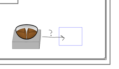

Thank you for your input! Yes, I intend to have the same picture from PC to PC. I have the block diagram ready, but the image file I am trying to call out when the program runs is fixed to my local desktop. I believe the easiest way to do it based on your reply is to have the picture on my block diagram. However, I tried copying and pasting the image on my block diagram, but could not paste it as an indicator. When I right-click on the image in my block diagram, the only options are "Original Size" and "Properties".
Do you know how exactly I may have it show up as an indicator?
*Edit: I was able to create an empty picture constant, but no idea how to use a .jpg file I already have and use it as a constant in my code.
Once again, thanks for all your help!!

You missed reading the part where I said you can read the image from the file.
It goes like this.

What would I do without you?! Thank you so much! I learned something new 🙂
