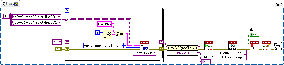

Approach A: Create a single task, containing two virtual channels (MyChan0 and MyChan1). MyChan0 contains cDAQ1Mod3/port0/line0:31 and MyChan1 contains cDAQ1Mod4/port0/line0:31. The Digital 2D Bool NChan 1Samp read VI returns a 2x32 array of Booleans. To flatten this into a 1D 64-element array, you need to use Reshape Array or some other method.
The DAQmx Task >> Channels property is there to show that there are two virtual channels named MyChan0 and MyChan1. Also, I used a for-loop to show that you don't have to hardcode multiple calls to DAQmx Create Channel. The "one channel for all lines" constant is redundant because that is the default.

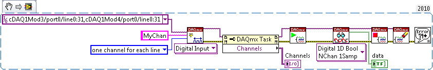

Approach B: Create a single task, containing 64 virtual channels (MyChan0 through MyChan63). This uses the "one channel for each line" constant, which is not the default. MyChan0 contains cDAQ1Mod3/port0/line0, MyChan1 contains cDAQ1Mod3/port0/line1, etc. The Digital 1D Bool NChan 1Samp read VI returns a 1D 64-element array of Booleans. If you used the Digital 2D Bool NChan 1Samp VI instead, you would get a 64x1 array because there are 64 virtual channels containing 1 line each.
