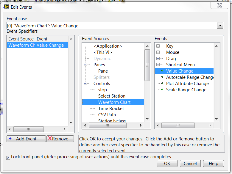

Hi  jordanglassman,
I do not have any solution for you, but I am interested, where can I found the events you mentioned in your post, please?
Thank you!
Message 2 of 8
(4,045 Views)
Check out the Edit Events dialog:
