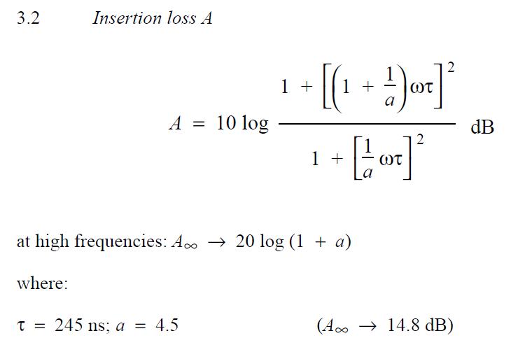

Can I filter noise, given a specific filter algorithm?
I have an array of waveform data captured at 120MHz. I want to apply a specific filter to it remove noise (weighted to perception of eye to noise). Can I implement this in LabVIEW? Any clues how please!

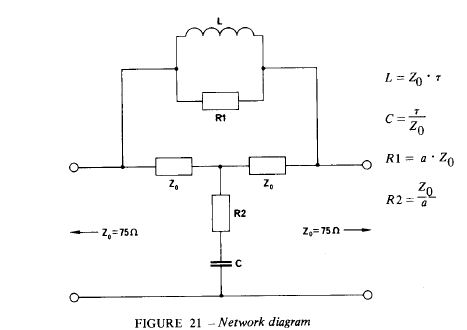

Filter circuit this looks like;

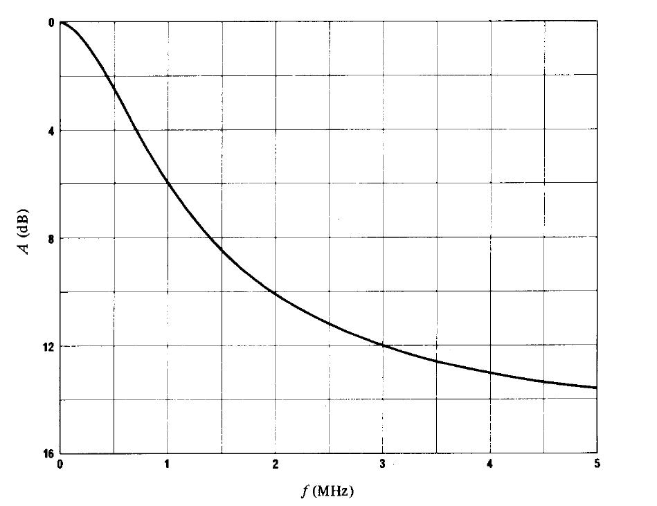

Response of filter looks like this;

Thanks ToeCutter, looking at IIR and FIR, I would need Forward and Reverse co-efficients if I used IIR, and FIR co-effiecients if I used FIR. I am at a loss when trying to understand how these parameters can be defined.
Can you/anyone give me direction in where I can find how to arrive at values for these for the equation given in the first post?
