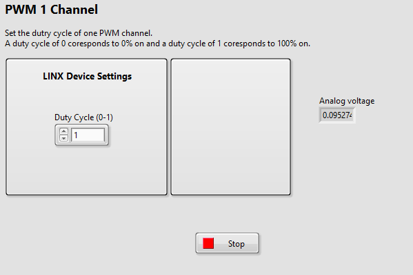

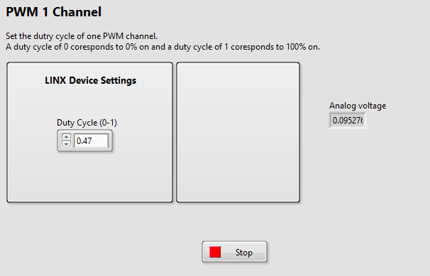

So for 100% duty cycle - I am expecting 0.095. I don't have any problem with this. The only problem that I am having is when I changed it to lower duty cycle, I kept getting 0.095 as you can see. I tried to throw an invoke node to reinitialize values, but it's not working.
Good  analog value
Wrong analog value
