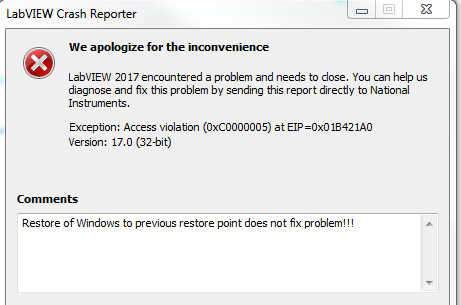

Can't start LabVIEW 2017, even after reinstall or Windows Restore-Point revert
Has anyone ever had a problem with LabVIEW crashing on start even after you reinstalled LabVIEW (and tried Windows System Restore to revert to a point before the problem happened)?
I believe there must be some corrupt file somewhere; I've tried manually deleting the compiled-code cache and the LabVIEW INI file but to no effect.  Can anyone think of any other file that LabVIEW might read on startup?

Problem fixed by deleting the entire LabVIEW Data directory.   Some file in there that LabVIEW reads on startup must have been corrupted, but I don’t know which one.
