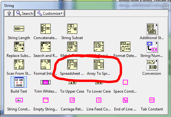

Convert the array to a spreadsheet string and store it that way.

Thanks for the reply - learnt a new function today!
It turns out the strings produced are too big for a single cell to handle - as such I'm going to have to rethink my DB archtiecture a little. That said, still a perfect fix for whenever you're trying to write less than about 3000 characters per cell 🙂
