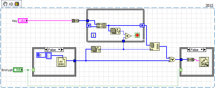

ok i've written my own encryption decryption techniqu can you suggest me some better methods

How about this?
I made it to work for text files, but it will work for binary files too with very little modifications.
Basic encryption is simple XOR a data stream and a repeating key, decrypt by XOR the encrypted data with the same key.
The longer the key the more secure the encryption.

Not to publish ... this is very simple ... i just want to know should i improve this or scrap this

You should not store the encryption key inside the encrypted file.
This makes your encryption weak in general.
You seem to have "security through obscurity" in your enc/dec algorithm.
You haven't replied but I guess I haven't answered your question either...
Sure it works but from a LV programming standpoint it is very redundant and Rube Goldberg like.
IMHO you should scrap what you have or at least clean it up.
I am a long ways from being a LV expert but there are the things that pop right out at me when I see your code.
You use identical code in three places, make it a sub-vi.
Why start with a constant of -1 and increment it once inside your for-loop? This value will always be 0.
Don't use array size to set the number of iterations of your for-loop then use the iteration counter to index an array inside the loop, use auto indexing.
Your block diagram is sloppy and hard to follow.
