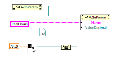

My LabView Project uses a .Net DLL. In the DLL there is a class "A2InParam". This class has a member "ValueDecimal" that has "System.Nullable[System.Decimal]" type.
I need to write something to that member.
I convert the "Double" constant (also tried "Single", "Extended") to .Net object and then cast it to "System.Nullable[System.Decimal]" type (using a constant, that was created by "create constant" function from "ValueDecimal").
But I get an error in "More Specific Class":
Type mismatch: Object cannot be cast to the specified type.

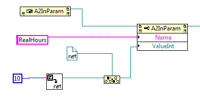

If I work with a type "System.Nullable[System.Int32]" it works fine.
Small test program (LabView2015) I have attached.

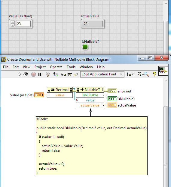

@Jason_Tut - you should be able to create an instance of Decimal (via the Decimal(double value) constructor) and pass that directly to the method. The CLR will unbox this value to a Nullable<Decimal> instance with the property HasValue=True and the call will work. Here's a quick example:
