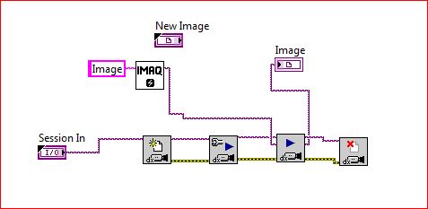

So what you need to do to "fake" an Image Control is to create an Image Wire, right-click it, and choose Create Control.  This, then, you can paste into a sub-VI to form something you can wire an Image Wire into.  Here's a Snippet:
When I right-clicked the Image Wire (created by dropping the IMAQ Create Image function and wiring it to your Image indicator) and said "Create Control", the Control shown as "New Image" popped up.  Notice that it is attached to a TypeDef (probably buried somewhere within vi.lib).  This will put its associated Control, shown below, on your Front Panel.

      Here is a snippet for your need. As Bob Schor said, you are confused between indicator and control. Just use IMAQ create VI to create a fake control for your image indicator. Using that image control you can create sub VI with connector pane and can pass data. Just create VI like here in this snippet, create sub vi from this code and select a seesion for webcam. Run it. You will find an answer.
Hope it helps!
