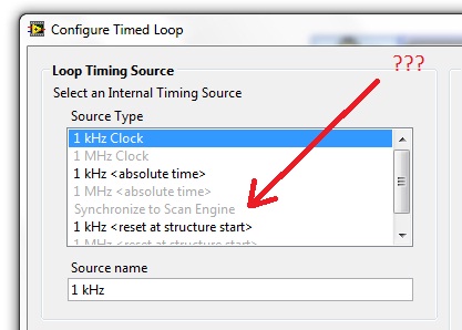

Hi I've got a cRIO-9073 that I'm trying to work with and can't get a VI to synchronize to the scan engine.  I'm alright with LabView in general, but pretty new to cRIO, Real Time, etc.  Basically the problem is that when I set up a timed loop in a VI on the target and double click to configure the timed loop, I should just be able to set te timing source as "Synchronize to Scan Engine" but that option is greyed out.  Any idea what I can do about this?  I can't find info anywhere telling me why this is greyed out or what to do about it.  The cRIO seems to be set up just fine otherwise, and I can read an analog voltage off one of the modules.  Using LabView 2010 btw (and not using FPGA).

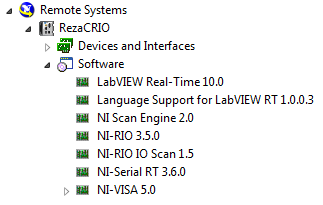

Hi Zach, thanks for your reply.  Yes I already have NI Scan Engine 2.0 installed on the cRIO.

Are you sure this VI is under the target in the Project Explorer? The window you see appears when I create a VI under My Computer.

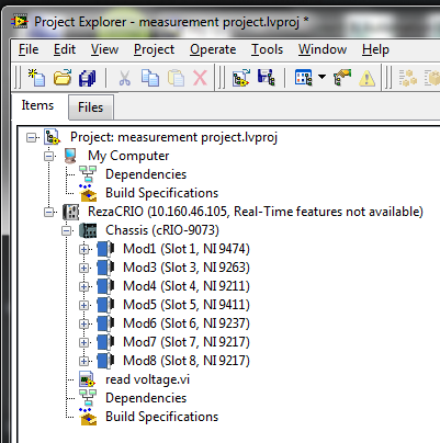

Yes, the VI is on the target ("read voltage.vi"):
I am thinking that some part of the problem may have to do with the fact the the cRIO says "Real-Time features not available."  This is despite the fact that I have Real-Time installed on the cRIO:

I think you are right, can you try reinstalling the Real-Time Module for LabVIEW? You should be able to see the Real-Time module listed in the tree under LabVIEW 2010.
Order of installation is important here, you need to make sure you install Real-Time for the correct LabVIEW version and then install a compatible NI-RIO version.
If that does not work, you can try to push software to the cRIO again. If you still see the message "Real-Time features not available", you may want to upgrade your NI-RIO driver to 3.5.1

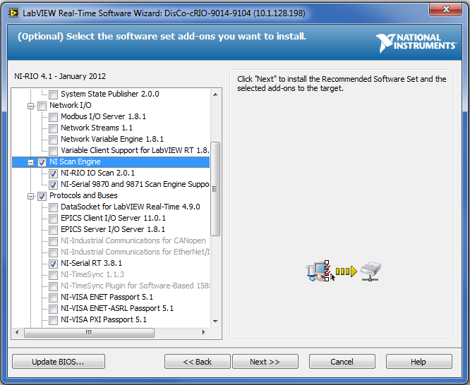

Scan mode uses a fixed FPGA personality to acquire data from the hardware. Programming in FPGA mode will allow you to customize how you I/O works and how fast it transfers to the Real-Time side of the cRIO, but the network communication speed will be the same for both. For getting started guides, you can check out the links below. Good luck!
https://knowledge.ni.com/KnowledgeArticleDetails?id=kA03q000000x2HMCAY&l=en-U (Scan mode tutorial)
https://www.ni.com/docs/en-US/bundle/labview-real-time-module/page/rt-best-practices-portal.html (RT Best Practices Portal)
