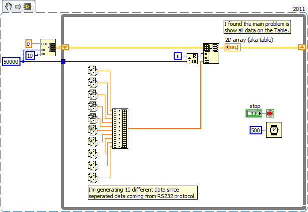

Before apply to my test bench i used "ReplaceArraySubset" blocks in trial versions. I generated 10 different random numbers instead of data from RS232 protocol. 11st data indicates index on the left of table in Front Panels.
As you see from Front Panels if i place Table in the loop i could capture 34811 data in 2700 seconds. On the other hand if i place Table out of the loop i could capture 41004 data in 1350 seconds (half of 2700 seconds).
I think the main problem is, to indicate all data on Table. If i don't want to indicate data everything is good, but when i want to see all data i cannot capture all of them.

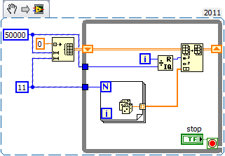

Hi sumsu,
why do yu think you need to build so many (sub)arrays when all you need is the one big predefined array?
Like this:
Defining an array of 50k rows and 11 columns before the loop.
Creating an array of 11 "random" measurement values.
Replacing a row in the big array.

Hi GerdW,
I'm generating 10 different data since seperated data coming from RS232 protocol. I recommend you that place Table in and out of your loop. Then you'll see difference between both of them. I found the main problem is show all data on the Table.

Hi sumsu,
I updated my snippet to reflect your comments. I don't see any "main problem" here…
When this doesn't solve your problem you need to explain it better!

@sumsu wrote:
Hi GerdW,
sumsu
Of course it will take longer if you are updating the table every time you get more data that if you collected the data and THEN posted it to the table.
If you want to display massive amounts of data as it comes in then switch over to a producer/Consumer architecture as was mentioned early in this thread.
