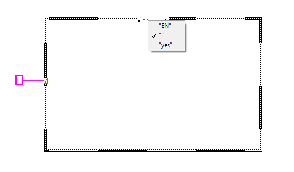

Hi Nathan
Since you are getting string values from your db, you can have 3 values for your case selector as shown in attached screenshot. Would that not work?

Hi Winter!
What would you connect to the question mark that controls the case? - John
Message 5 of 16
(5,011 Views)
That would be the string output from your database.
Message 6 of 16
(5,007 Views)
Of course you should ensure that the strings are clean and don't e.g. contain a termination character or similar. Maybe pipe it through "trim whitespace" before connecting to the case structure if this is a concern.
