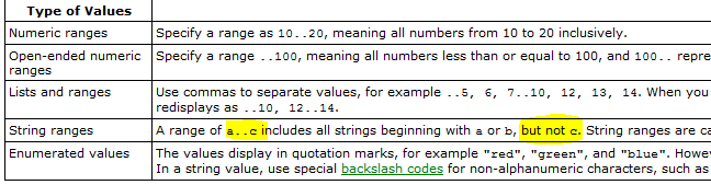

Case structure not working for string
i have a case structure where one case is "1".."4".
Then a string input.
When i enter 1, 2 or 3 the case is working. But not for 4.
Why this?
Labview 2015
Edit: Correct attachment selected.
Message 1 of 18
(10,954 Views)
Accepted by topic author OnlyOne
The end string is not inclusive.  Try making it "4!" and it should include the 4.
Of course, if you are only dealing with integers, it would be better to convert to the number and then use the case structure.
Message 2 of 18
(10,923 Views)
This is works as intended.
Please review the LabVIEW help under "Entering Values for Each Case Structure Subdiagram":
Norbert
Expert: Geometry
Message 3 of 18
(10,922 Views)
Wow - I never would've even known this.  I would've just expected it to be inclusive like the Numeric ranges.  Thanks for helping me avoid a pothole!
