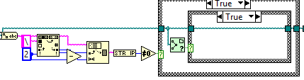

By the way, I added code to identify and extract the network computer name from the path, ran that into the "String to IP"-function and added a test to not run the "Check if File or Folder Exists.vi" if the IP returned as "0". This solved my problem!

Hi bmann200,
This is what I did:
Basically I strip the computer name from the string converted path and then validate it using the String to IP.vi.

Many thanks Treigstad, that works, problem solved, I can see if the Network PC is available or not.
When I read \\PCname\folder\folder\file from file, the LV "string to path" function converts it to C:\PCname\folder\folder\file because the file read removes a backslash from the start of the string.  I'm now having to write a VI that determines if the path if a drive letter or backslash, and add a backslash back in if it's the later.
