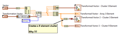

While using the Euler transform VI (3D Cartesian Coordinate Rotation (Euler) VI) I came across a cluster size issue I don't understand. Not a huge deal as I can get over it easily, I'd just like to understand:
Using the Euler VI in scalar mode, gives me the XYZ coordinates that I put in an array and then transform in a cluster.... of 9 element... Why?
I really don't get it. Same for the transform vector input, LV shows the little red triangle to say that types don't match, but they do ....

Right click the array to cluster node; you can set the cluster size there.

Lol didn't know that ...
Never had an unmatching cluster size because of this function before...
Anyway, thanks.
