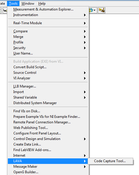

Another option is that you're not looking in the right place. It's under LAVA (I think this was a requirement of either the LAVA certification or of the LVTN):
Technically, this is done by having a VI called <LabVIEW>\project\LAVA\Code Capture Tool__CCT.vi, so you can check if it's there if you still don't see it. If it's not, I would suggest maybe uninstalling and reinstalling.
