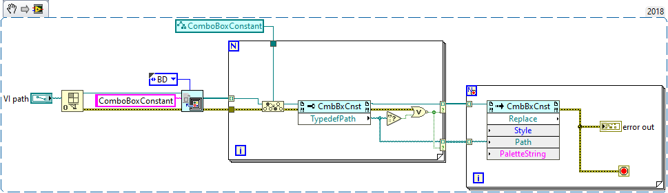

You can do this if you do a "right-click -> replace" on the constant, and select the newly updated type definition as the thing to replace it with.  The value will be preserved, the drop-down will update.
If you have tons of these, you can automate it with VI scripting.  This should do it for all constants in one file:
You can modify it to do this to all files in a directory, in your project, whatever scope you want.  That part's up to you.
