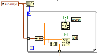

I'm writing some data to Excel using the Report Generation Toolkit. I'm writing a 2D array of double, and when I place this data in an array and display it in LabVIEW it gives me the right numbers with decimals. When I write the exact same data to Excel I get the right numbers but without decimals. For example: 1,23 becomes 123.
This is how I fetch the data, it's from a history node. The ouput array is used to calculate some other data and this is added to the array. This is the array that I write to Excel.

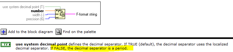

Well what are thos False constants doing on that Block Diagram?  Change them to true .
Minutia can bite you if you don't read the help file carefully.

I did read the help file, but those 2 blocks aren't used eh?
I converted them to a string and that helped me out, thanks!
