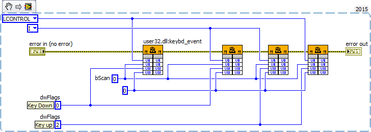

As Gerd said, use user32.dll:keybd_event to send key-presses one after the other... Ctrl + i...
