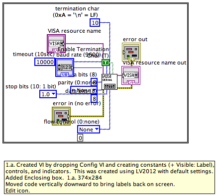

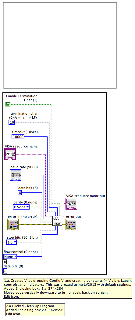

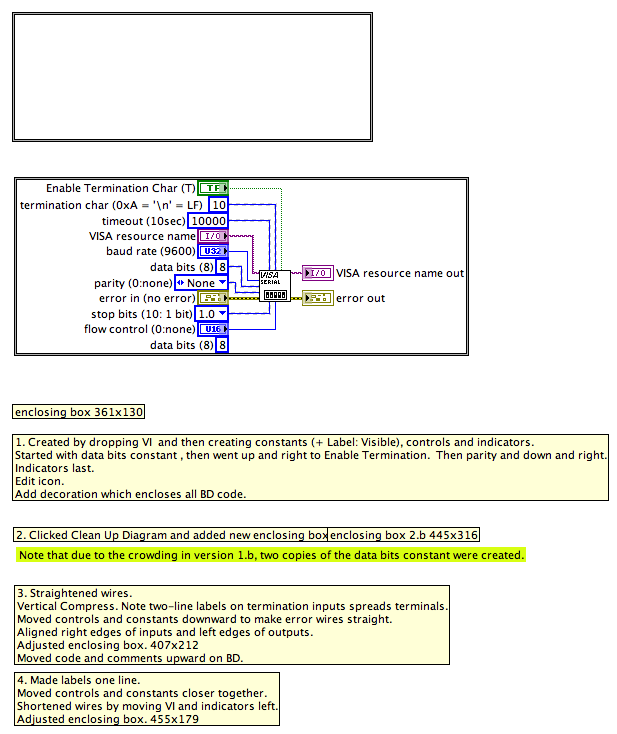

I like neat diagrams and probably spend too much time getting them that way.  Over the years I have learned to program in a style that is comfortable for me so that I rarely need to edit a diagram for looks.  I also keep the auto wire routing tool turned off. I think it creates some really strange wire paths.
I do not like the Diagram Cleanup tool.  I never use it on my own programs because its idea of good style and mine are quite different.  When I use it on some of the code downloaded from the Forum, I find that it sometimes is a decent starting point.  At least it moves controls left and indicators right (although it gets the justification wrong). It also does a poor job of placing shift registers.
This is the way LV with default settings (using VISA Config Serial Port.vi) places controls, indicators and constants:
After Diagram Cleanup:
Since I do not use Icon view of terminals and a different label placement, my version looks a bit different.  This is the way I would have coded the same thing:
I do not have the VI Anayzer, but have reason to believe that it does not like the constant and control terminal borders touching. In this situation I think that a one pixel overlap does not reduce readability significantly while keeping the diagram compact and as many wires as possible straight.
Lynn
