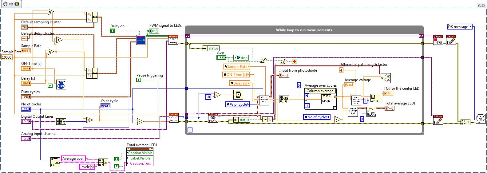

I'm currently set to work on are project where the basic is that 3 LEDs are blinking with a PWM. The LabVIEW code are handed over to me and now I have to adjust from generating the PWM signal form LabVIEW to controlling the LEDs from PSoC-4 with an LED driver TLC59711.  I'm not familiar with PSoC and I'm supposed to get my PSoC-kit and the driver later to day. I do not have any clue of how I should connecting the PSoC code + driver to my LabVIEW. Should I use the NI-VISA, and how does this work. I'm sorry for the lack of detailed information but I'm still not sure what I should do, but hopefully it will come to my along the way. But let me now if you need other information and I'll try to collect them.
Could anyone give me some start advice?
The code I think I need to replace is digital part in the upper left corner of my snippet.

I suspect that your code is doing much the same thing.  I can't see the sub-VIs (such as Generate PWMs V3.5), but these might be "Tell the Chip to do such-and-such", and might be where the significant code is located.  It does look like something is acting as a DAQmx device (the Analog Input Channel goes to "Analog input setup V2.0") -- could it be that you actually have LabVIEW Drivers for this microcontroller?  [That would really make things simple ...].

Generate PWMs V3.5
Yes, the "Generate PWM's V3.5" tells my LEDs to blink in a certain pattern. This part is still going to be a part of the system, but is programmed onto the LED driver TLC59711, that one of my colleagues is doing (some C code). So I dont know if that is what you mean by the "LabVIEW Drivers for this microcontroller"? Otherwise I downloaded the VISA driver, but agian not certain if that at all was nesseceray..
