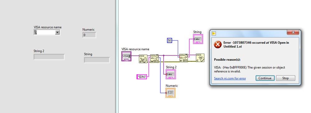

I'm using Keithley 2400 through KUSB-488B GPIB-USB converter and my system is LabVIEW 2017 and Win7.

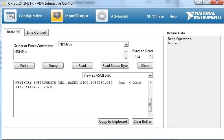

I checked NI visa interactive controller in NI-max and it works very well.
I confirmed keithley2400 respond "*IDN?" command and I can see my instrument in this menu absolutely.
The problem is I can't control it through LabVIEW!
I attached my VI and block diagram.
Is there any generous friend who can figure it out?

Switch out the string with an actual visa resource. Right click on the visa resource input >> create control. Then select your resource from the dropdown if it is there.
You'll want to use Visa open and close before and after you communicate with the instrument.

I tried but I can't find any instrument that I need.
GPIC address is 24.
GPIC address is 24.
That error...
error2
is telling you the comm port you DID NOT SELECT was invalid.
Find the device in Max and use the same port spec in your VISA resource name control.

I can find Ke2400 in NI-MAX and it communicates well.
But when I try to find it in LabVIEW. I can't see anything.

It shows similar error message.
I guess this is  a problem of LabVIEW2017, because it communicates well with NI-MAX, is it right?

I don't think the error is due to the termination character. The error message indicates it occurred in VISA Open.
I can't remember the exact circumstances, but there was one time "Refresh" wouldn't list all the resources. I had to use the VISA Find Resource function.  Try it and see if your resource shows up. This function is located in "Instrument IO -> VISA -> VISA Advanced"
