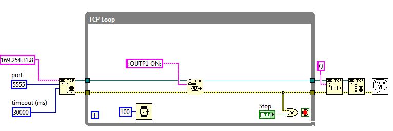

Im trying to communicate with a RIGOL DG4162.
Using the visa library and the instruments divers works and it's fairly simple.
Im trying to  connect without this resources, over a simple TCP connection and be able to send the SCPI commands to the instrument. I need to do this becouse we will later need to implement the communication in a siemens PLC (PLC to RIGOL communication) in wich i cannot install VISA drivers...
Im able to open the TCP connection with the instrument using port 5555 and the instrument IP adress, but writing the same commands wich work with the VISA driver, using the TCP Write function won't work. Any help would be apreciated.
First off, do you realize that you are sending the same command ":OUTPUT1 ON;" every 100 msec in your loop until you hit the STOP button? That's probably not what you intended to do.
As Sam said, use a "\n" to terminate the command. Make sure you have the '\ Code Display' selected before you enter the \n in the text field (Right click the command text control and select). Also take his advice and research the communications protocol. After that, the easiest way for you to test out your TCP/IP raw socket is to use NI MAX. What I do to create a raw socket is:

IMHO not advised to send same command every 100 msec ad infinitum until STOP button is pressed.

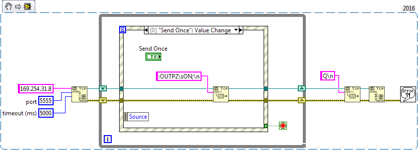

You still have a problem with your VI. Your "Send" control has a mechanical action of "switch when pressed". This means that it stays TRUE until you press it again. So, it will continuously send the same command every 100 ms.
I modified your VI to use an event structure. It will only send the command once when the "Send" control is pressed (mechanical action is latch when released). It will exit the loop when the stop control is pressed and then finally send the "Q" command.
Don't know if your TSP loop is the reason for your error, but it's not advisable to repeatedly send the same command every 100 ms to an instrument. It will probably fill up the buffer, lock up the machine because it is performing the instruction over and over again, or a combination of thereof.
As for the source of your problem, I can only speculate. Is the command syntax right? Is "2" a valid channel number? On some OLDER equipment, I had experienced some quirky behavior with using the ";". The ";" is mainly used to concatenate several commands together. The older instruments would NOT execute any command until ALL commands are sent over. Newer equipment will execute the command upon receiving the termination (\n). Try the command without the ";". Does the final "Q" command also need the \n termination? I have also seen other instruments buffer the commands until some type of "execute" command was sent. Can't think of anything else at the moment.
Message 9 of 13
(12,671 Views)
The boolean is set to latch when pressed, so thats not the issue. Im sending commands 1 by 1. Migth be the ; ... Will try again on monday :")
