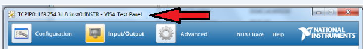

Take a look at the Title bar message. Your connection is TCPIP0::169.254.31.8::inst0::INSTR. You did not create a raw socket connection. Otherwise it would be in a different  format.

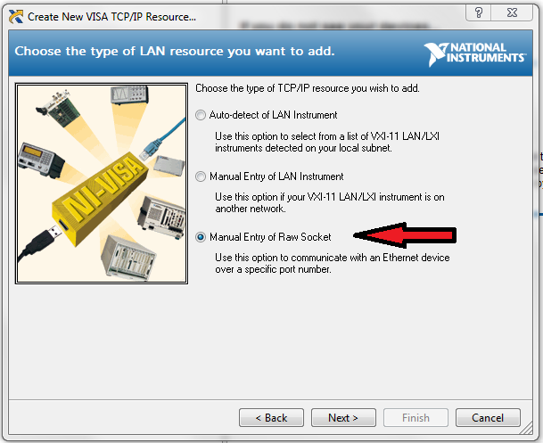

I believe that you may have used the "AUTO-DETECT" in NI MAX which sets the connection up as a VXI-11 INSTR. That connection works fine in NI MAX but you really want to test out the IP/Port 5555 connection. Choose "Manual entry" to create the Raw Socket. So this leads me to ask, are you 100% positive that the port number 5555 is correct? After you enter the IP address and port number when creating the Raw Socket, there is a "VALIDATE" button. Press it and see if your port is valid.

Your rigth, is not a socket, however port 5555 is correct and is the only port I can successfully open a raw socket connection in NI MAX (have already tryed). However, when using the socket config in NI MAX the instrument does not respond to the same commands that work with NI MAX and VXI-11 protocol. So that probably means my instrument just does not work with raw socket, we will try with another function generator which does support Raw Socket connection, as this migth be the problem.
