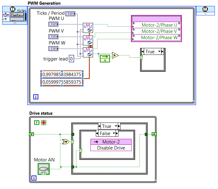

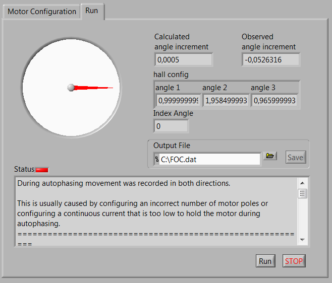

Hello Community,
to display what I am dealing with I made a screenshot of the values and the error message I always get.
Maybe this is going to help a little bit more to understand my problem.
I have started to make a problem without the FOC only to spin the rotor of the drive.
Therefore i copied the PWM-Modulation and the Drive-Enable boxes from the FOC Programm and modified them a bit.
As a result nothing happend. The only thing I noticed is when I change the duty cycle of one PWM signal the drive starts to peep low.
I hope this additional Information is helpful.
