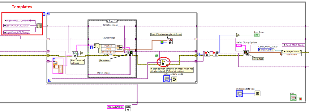

My program is the next (attached as well):
The problem is the next:
· If I do this just for one iteration, code works fine. But the problem is that when i do the next iteration, the defects of before iteration is removed, so always I get the defects of iteration 3 (the last iteration) so I thing that I need to create a image with all defects, so combine "defect image" in every iteration in one. I try to do this with IMAQ add (red circle in image) but it does not work.

You're using a shift register with a single buffer.  The shift register will only store the last value.
You want to get away from the shift register.  Then, you want to allocate three buffers and feed those into your for loop so the first iteration acts on the first buffer, the second on the second, and the third on the third.
That way, each iteration is working in a different space.  Otherwise, each iteration will clobber the work done in the prior iteration.
The golden template is working just fine if this works in a single iteration and you get the last template's data with multiple iterations.  The problem is the way you're storing your calculations.

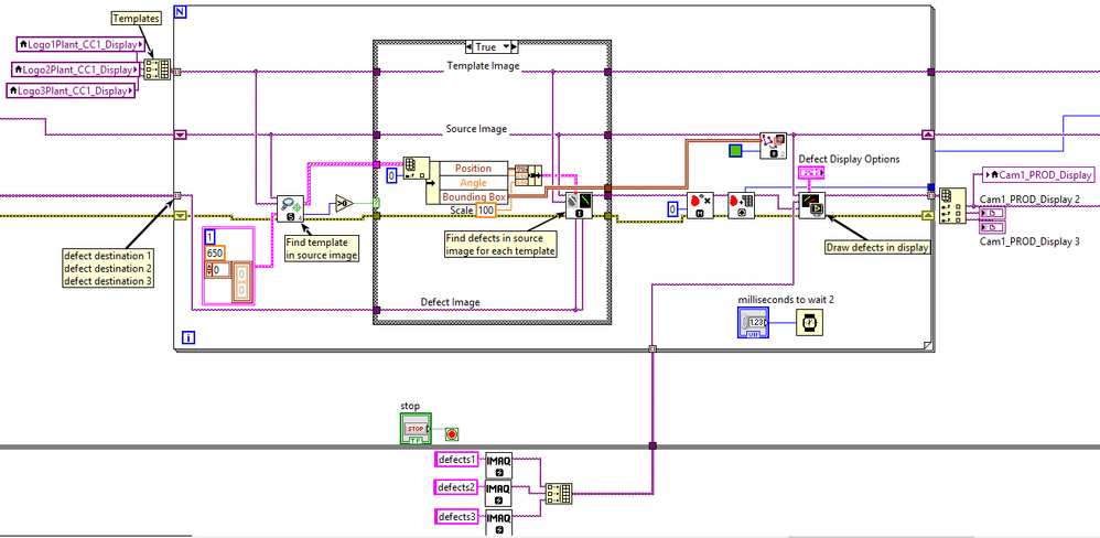

Thanks a lot for replying.
I do what you say and now I have the next code:

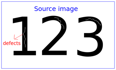

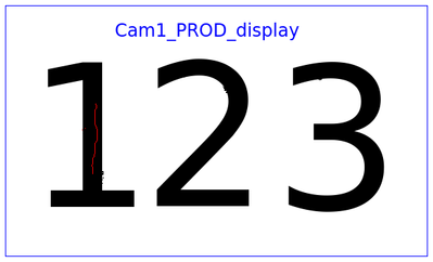

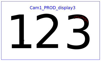

But as you say, I have now three images (Cam1_PROD_display, Cam1_PROD_display2, Cam1_PROD_display3) with defects drawn in each templates, I mean, defects in template 1 are drawn in Cam1_PROD_display, defects in template 2 are drawn in Cam1_PROD_display2, defects in template 3 are drawn in Cam1_PROD_display3. Something like this:
· Source image is the next (with defects in white):
· Templates are:
    Template 1            Template 2              Template3
- And the displays Cam1_PROD_display, Cam1_PROD_display2, Cam1_PROD_display3 show the next in each display (with defects in red):

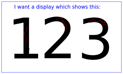

- But I want just a display which shows all defects in one image like this:
How can I do that with the code that I have?
