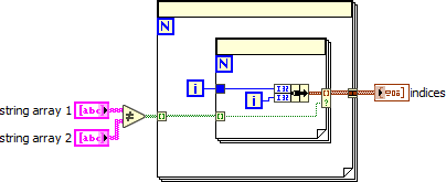

Go row by row and compare the 1-D arrays.  If they are different then look for the Falses in that 1-D array.
(4,506 Views)
Accepted by topic author KwanSHL
try this:
(Hint: Conditional and concatenating output tunnels…)
(4,484 Views)
Thanks guys, this will do the trick!
(4,478 Views)
(The above assumes that the two arrays are identical in size and that equal entries need to be binary identical. Depending on where these strings come from, you might want to do a case insensitive match and/or ignore leading and trailing whitespace if present.)
