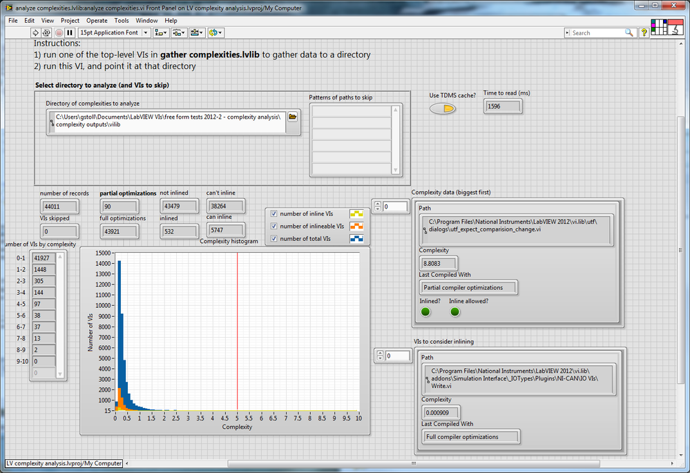

I've been working on a tool to analyze the compiled code complexity for VIs in a project/directory.  (this is a new feature in LabVIEW 2012) I've attached the tool below.  There are two steps to use it:
  • Gathering the complexities: under gather complexities.lvlib, run one of "gather from directory or llb.vi", "gather from project.vi", or "gather from projects.vi" and specify where to read the VIs from and where to put the output.  This will generate a series of text files, one per subdirectory.
  • Analyzing the complexities: under analyze complexities.lvlib, run "analyze complexities.vi" and point it at the directory with the text files in it.
The front panel of "analyze complexities.vi" looks something like this:
On the bottom is a histogram of code complexities.  Above that are some statistics (the most interesting being how many VIs were only compiled with partial optimizations), and to the right are all the VIs sorted in descending order of code complexity, so you can easily see the biggest ones.  It also finds VIs that could be inlined and have a low complexity, and shows them under "VIs to consider inlining".
I think this will be useful for larger projects for informational purposes, to find VIs that are "too big" and not being compiled with full optimizations, and finding VIs that are good candidates for inlining.

If you have VI's with code complexity greater than 5, then that means
- they're not being compiled with full compiler optimizations, so they'll run slower than they could
- they're big and probably good candidates for refactoring
If you have VI's with very small code complexity, they're probably good candidates for inlining, which will make them run faster.
This project will help you find VI's in both categories.  (I'm into numbers, so I love the graph of the frequency of code complexities, but it's not that useful)
