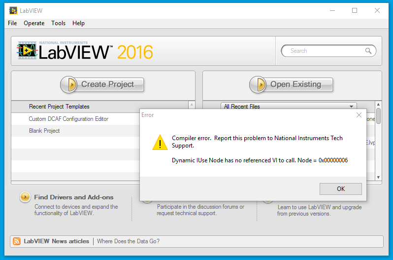

I ran into an odd problem that I've never seen before.
I have a project.  I have a module that does some datalogging / pdf stuff.  If I open the project first and then open that module it is fine ... code runs, compiles, no problem.  I've been using this bit of code for almost a year now.
However I noticed something odd today...  if I open it from disk without opening the project first, I get the following error:
Not only that, LabVIEW then crashes on program close and I have to kill it from the task manager.  I've verified this on two separate computers

A good one, make sure you forward this repeatable case on to your local NI support.
(4,659 Views)
Hi BowenM,
Could you provide the code that you're using that is causing this error? Do you happen to know if it's any particular VIs/functions in toolkits or addons? If you can pare down your code to the smallest reproducing case, it will be much easier to identify the root cause.

I'll try on Monday. I thought it an odd curiosity and didn't dig too deeply.
(4,612 Views)
Unfortunately, I was unable to narrow it down to a single specific bit of code and ran out of time to mess with it.  If someone from NI wants to investigate more I can do some screen sharing or something, but I'm not going to post an 1800 vi project 🙂
