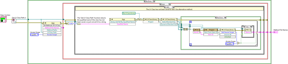

Is there a more efficient way of getting the list public member VIs for a class using the LV class data type for which hasn't yet been saved (yes, it's a corner case)?
The following requires the VI references be a Project Item reference in order to read their scope.
VI (2018 & 2009) also attached

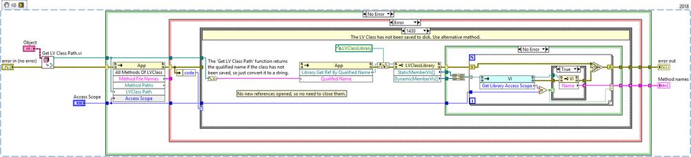

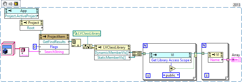

Might want to close some of those refs, but this seems to work in principle.
(3,392 Views)
Thanks! A good solution as always.
I just used the Get Library Access Scope method and removed anything project related in my original.
