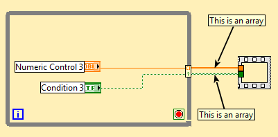

Start with a While Loop and conditionally autoindex a scalar:
Example 1
As indicated, the boolean output is a scalar.

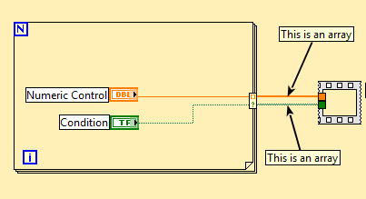

Now try the same with a For Loop (DO NOT REPLACE THE WHILE LOOP above by a For Loop. CREATE A BRAND NEW FOR LOOP):
Example 2
OK, so now, the boolean output is an array. Cool, that's what I wanted with the While Loop above, but was unable to achieve.

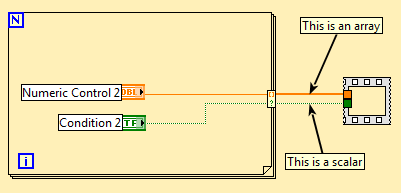

In Example 1 above, replace the While Loop by a For Loop. Here is what you'll get:
So you CAN output a scalar Boolean in a For Loop, but you have to go through a While Loop to obtain this.

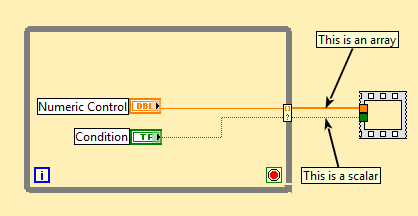

Now replace the For Loop in Example 2 by a while Loop:
Alright, here is my Boolean array output. But I had to go through a While Loop to do so.
I'd say this is a bug and the conditional indexing boolean output should be an Array (not sure whether there would be any point to have it be a scalar; last value output?).

Sam is correct: the conditional terminal is not an output of the for loop. When you "dragged it through" to the sequence you were actually creating a (non-conditional) indexing boolean array output. Click "diagram cleanup" and you'll see this. (I suppose it could be a bug that LabView allows the two nodes to stack on the same place on the loop.)
By the way, you can always output a scalar from a for loop. Right click on the tunnel, set it to "last value".
