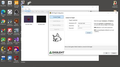

I have a problem. I am triying to program Raspberry Pi 4 with LabVIEW, but the device isn't recongnized... I did the necessary configuration....

 I want to program RPi 4 with LabVIEW for IoT applications ...The version of LabVIEW is 2019 and I occupy the Markhup toolkit...

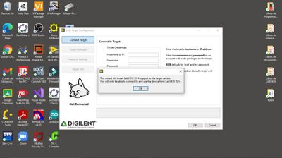

I think you have the answer in your first picture - "You will only be able to connect to and use the device from LabVIEW 2014".
NI refurbished the LINX toolkit in LabVIEW 2020 Community Edition (which is free), so try out that one.
Also, all the discussion about the LINX toolkit have own thread on the forum, check here:
