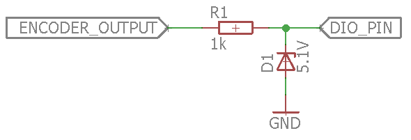

3 resistors (pull-up, pull-down, input) and a Z-diode (5.1V) to protect the DI pin…
According to the datasheet of the USB6356 you could even connect your encoder directly to the DIO pins, but I would prefer some external protection circuit to be an the safe side! (It already mentions an internal pul-down resistor you just need an input resistance with a Z diode…)

The CWZ5GH - a small functional circuit diagram is given on the first page. It consists of a pair of transistors (one PNP, one NPN, each being connected to the appropriate power line (+ve, gnd) by a 7.5 Ohm resistor, with that in series with a 24 Ohm resistor to output.) Simulation with LTSpice and reading on wikipedia give me a basic understanding of pull-up/down but it's unclear how I would size a pull-down to get a 5V high for arbitrary input voltage. I could size it for 17V, but then if I change to 16V for some reason, my resistor would need changing (Perhaps this is just how it is, without a comparator circuit?). Seemingly a pull-up resistor will make my high level be the same as the power +ve rail, which will be far too high to be recognised as a 5V TTL for LabVIEW.
Your description of components needed makes me think I should have the output connected to both +ve and gnd with a resistor each, then connected using the diode to prevent voltages greater than 5.1V being passed as a digital input - I suppose that this neatly avoids having to size the pull-up resistor too carefully to the power supply, but I imagine you didn't mean for me to use it as a voltage regulator.

Hi cbutcher,
the encoder uses a push-pull output which simplifies the design. The internal pull-down of the USB6356 makes it even easier:
(4,462 Views)
