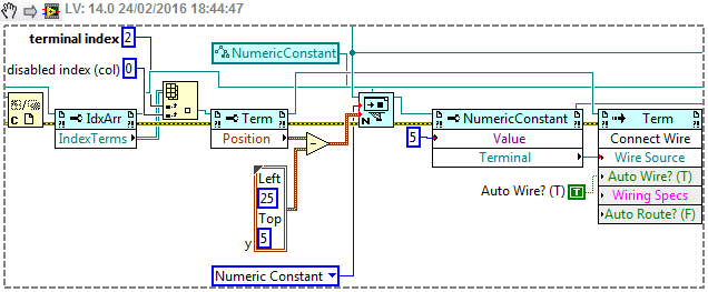

So i create one index array and one constans with script.
Two questions:
Q1:
example: i want to wire the constans to the array index 5
Q2:
example: i want to wire the constans to the element index 5
pls help!

@mogergog wrote:
Two questions:
Q1:
Q2:
pls help!
Sorry, I am not sure I understand what you are asking! Also please post VIs or Snippets instead of jpeg's. This will allow others (mostly volunteers) on the forum to help you quickly.
This snippet may help:
CLA CTAChampionI'm attending the GLA Summit!

Thanks for the solution!
Sorry for my english. (Never learned) 😄
You understand well! 🙂
Ok, next time i will uppload pictures that way.
