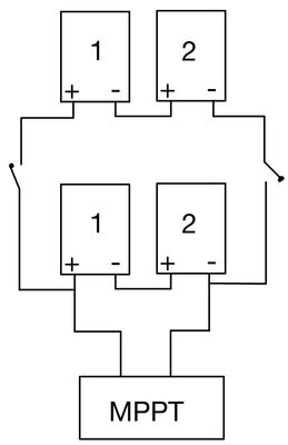

 Hello all,
I am working on a project for my Mechanical Engineering class on Mechatronics. The project is based around solar panels, my team needs to use the MPPT 150/70 – MC4 VE.Can, the DAQ-6212 and control 2 relays that will connect 2 panels that are in series with 2 other panels in parallel (i will provide a drawing). I have no idea how to program this, or if i can even control and use the relays with the DAQ. The Voc for each panels is 43.4V,  the Isc is 12-15A. I would appreciate any help and tips possible 🙂

Can one use USB-6212 to control relays? yes, absolutely, some additional circuit needed however.
Once you connect USB-6212 with relays, can you develop a program to control the relays in a manner to mix-match the connections? yes, some program has to be developed in a language (LabVIEW, C, .NET, Python, MATLAB etc.,)

My suggestion would be to use the DIO outputs from the DAQ-6212 to control the low side of both relays.  Connect the +Supply to the +side of the relay coil (If these relays do not have a flyback diode, it is a good practice to add such as close to each coil pins as possible).  Now connect the negative side of the relay coil to the high side of the digital output.  Lastly, connect the negative side of the digital output to the -supply.
The DAQ-6212 can provide up to 2 mA using the Analog Outputs or 16mA max using the Digital Outputs.  Get two 6V relays with contacts that can handle the necessary current produced by the solar cells.  The coil impedance needs to be within the parameters of Digital Outputs.  Looking at a 600-ohm coil would give 16mA * 600-ohms per relay.  As there will be two relays in parallel, the coil resistance would be halved.  [16mA * 300-ohms = 4.8V] The 6V relays would need to be able to operate with a supply voltage of under 4.8V or you need to find relays that have a higher coil resistance in order to remain below the 16mA max current of the Digital Outputs.

Be cautious.  Your professor is correct, but you need to understand the capabilities of your DAQ and Relays.
  1. The Analog out is capable of +/- 10V at up to 2mA max which would not be sufficient for most relays.
  2. The Discrete Out is capable of handling up to +/-20V at up to 16mA max which would be sufficient for many relays available.
    • Actuation voltage of the relay
    • Coil Resistance
  3. If the relays used do not have a diode across the coil, one should be added to prevent Inductive voltage spiking (See Flyback diodes).
  4. The relays selected should have contacts that exceed the maximum solar cell sourcing requirements.
  5. An external power supply to drive these relays will be needed that does not exceed the 16mA max current limit of the Discrete Out.
    • Use the Discrete Outputs to connect the negative side of the coil to power return rather than on the power supply side.
  6. Control of the Discrete Outputs to control the actuation of the relays falls within the capabilities of LabVIEW.

Be more than cautious actually! Unless you use small PCB mounted low power relays, connecting a relay directly to a digital output is a pretty sure way to fry your digital outputs, even if you use flyback diodes. And not every diode is a good fly back diode. It needs to be pretty fast switching to be able to really protect the digital output. As they are operated in reverse mode until the relay is switched off, there is quite a large electronic charge in the diode that first needs to be depleted and in that time the relay coil can easily build up several multiple of its operating voltage as reverse voltage and that can break down your digital output transistors before the diode is able to carry the current from the coil and limit its reverse voltage. It may not fail immediately but continues switching that exceeds the safe reverse voltage of the output transistor in the digital output will eventually weaken it to the point where it will break down.
Basically trying to directly drive relays that are not specially designed with logic level control inputs with a digital output is almost never a safe idea in the long run.

You need a contactor (not just a relay) rated for at least 100V DC and 20A; these are typically available for Solar applications.

The easiest way to drive DC relays with a DIO is to use an open collector driver IC or a small MOSFET.
It depends what you consider a small MOSFET. The typical SMD types such as SOT-23 may actually be a little small for a 100VDC 20A contactor relay just as the simple TO-92 based MOSFETS may not be enough.
