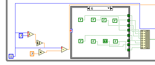

Although it has negligible effect on the data issue, the way you get the binary data for the DAQ outputs definitely qualifies as Rube Goldberg. the way you do it is shown below.

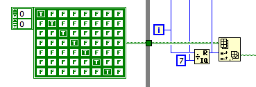

A much simpler way is to use Quotient&Remainder and Index Array with an array constant.
