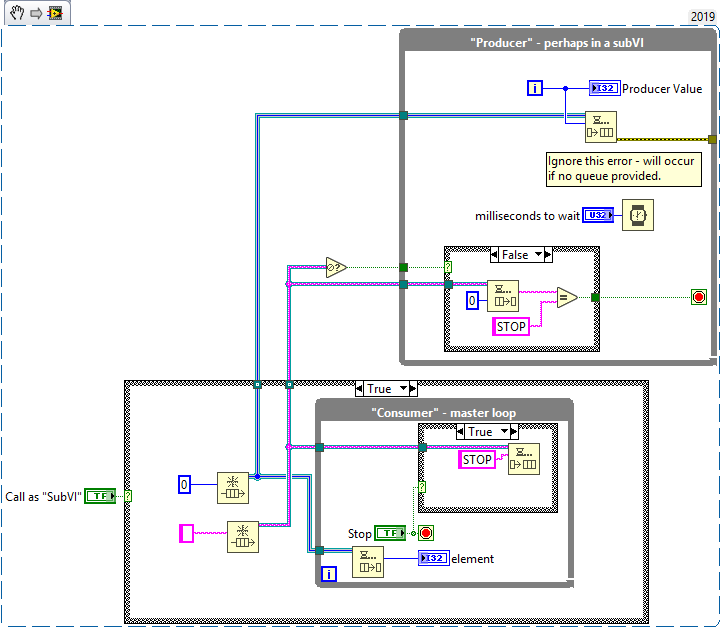

Although not a great solution, the simple answer is to have the controlling VI exit its own loop then force close the queue reference. This will cause an error in the other VI's loop when it next tries to use the queue function, which you can connect to the stop condition in the loop.
This is not great because generally it's not an amazing idea to cause errors for normal operations (i.e. stopping). A more robust/safe method might involve using multiple queues and a state machine. You could use one queue to pass the data from producer to consumer, and another queue to pass instructions (perhaps using a typedef'd enum) from your master to the slave (whichever way round you wanted to do this).
You can also then implement (consider using the Not a Queue function you already used) some alternative method of control for the Producer, if you really want this to act as the slave.
A possible example is attached - obviously you could extend this to use more than just a STOP message (and rearrange it to avoid the Case Structure) - I chose to use the CS and String rather than Enum to avoid subVIs or typedefs for the forums.

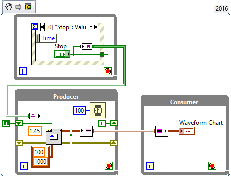

I think you don't understand the idea of the Producer/Consumer Design Pattern.  There may be exceptions to what I'm about to "generalize", but these can (probably) be dealt with easily:
  • The Producer is "in charge".  The Producer/Consumer pattern begins when the Producer starts "Producing", and ends when the Producer gets notified that things are at an end.
  • The Consumer is a "tool of" (or "slave to") the Producer.  As long as the Producer is alive and Producing, the Consumer must be alive and Consuming.
  • If you have Channel Wires, the easiest way to configure a Producer/Consumer Design is to use a Stream Channel Wire from Producer to Consumer.  Every time data is placed on the Producer's Writer, it will appear on the Consumer's Reader.
  • When the Producer decides to stop the process (and end its Loop), it should wire a "True" to "Last Element?" (to tell the Consumer that this is the last time it needs to read from the Producer).  In some instances, you may also want to set "Element Valid?" to False.
Here's a Snippet of a Producer/Consumer governed by a Stop Button (in an Event Loop, itself a kind of "Producer").  The Producer is simulating a DAQ Device reading a sinusoid, 100 samples at 1 kHz, and sending its output to a Consumer for plotting in a Waveform Chart.  Note that the Stop Button is used to stop the Event Loop and (via a Tag Channel) stop the Producer (and signal the Producer to stop the Consumer).

To followup on @natasftw's notion of guarding against a gross mis-match between Producer and Consumer speed, it is easy to modify the Demo I presented to cause everything to shut down if the Consumer gets too "backed up".  I'm going to leave this (in part) as an "Exercise for the Reader", but here are some of the steps you could take:
  • How can you tell if the Consumer is lagging behind the Producer?  The Stream Reader has an output, "Count", that says how many unprocessed elements are left in the Channel after the current element is removed (it should, ideally, be 0).  You could test for, say, >10, and if so, put a "True" on a Tag Channel, take it out the right side of the Consumer, bend it up and over the top of the Loop and join it to the existing Tag Channel that stops the Producer (which stops the Consumer after letting it empty the Channel).
  • What's missing from this solution?  "Two out of three isn't too bad ...".  In LabVIEW 2016, there isn't an elegant way to stop the Event Loop -- Event Messenger Channels were added in LabVIEW 2017.  So find an "inelegant" way (say, a 100-msec TimeOut Event processing some input ...).
Bob Schor
