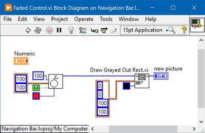

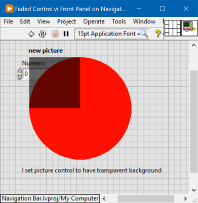

VI_RA: I came here looking for the same info. Odd how the zombie thread comes back at the same time. 🙂 I figured out what WayneS was doing. Here's my front panel. By setting a picture control with a transparent background (and border) the picture control itself cannot be seen. In the places where I use the regular draw commands (i.e. the circle), the image is opaque. But in the places where I use Draw Greyed Out Rect.vi, the image is translucent. When placed over the Numeric control, you can see it become dimmed. Draw with white if you want the typical "ghost control" effect. Attachment saved in LV2020.
Honestly, this isn't what I want for my UI... I want to be able to fade the control away entirely as an animation, so I'm still looking around for a solution. But maybe this works for you.
