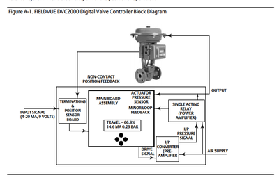

I have a question for controlling a valve via DVC2000.
I have DVC 2000 with the old control system. But, I want to upgrade this device with NI system.
DVC 2000 is controlled by 4-20MA with 9 voltage. Could anyone recommend what I have to use CompactDAQ system?

It seems like an NI-9265 module would be good choice in a cDAQ chassis.
https://www.ni.com/pdf/manuals/374067a_02.pdf
