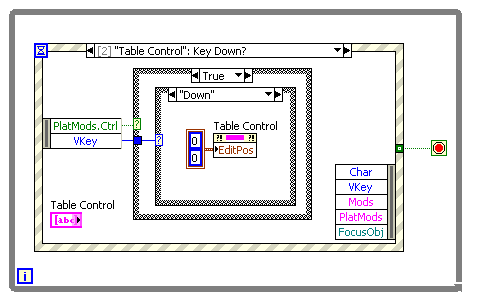

To enter in an edit mode of the table with keypad, you can use the event "Table":Key Down? and insert the property node EditPos as written.
For example, if you want <Ctrl> + Down to obtain edit mode:

To enter in an edit mode of the table with keypad, you can use the event "Table":Key Down? and insert the property node EditPos as written;

Effectively, I can't enter in edit mode with <Shift> but only navigate when firstly inside.
I 've consulted LabVIEW Help as you, find the same information and I didn't find a native soluce to enter in a table ... only the code. Sorry.Smiley Sad
