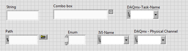

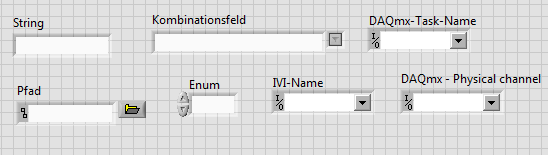

Placing string, enum, path, DAQmx I/O, VISA controls (seems any control related to strings) from Modern or Solver in Front Panel (or using QuickDrop) the size appears to be different in LabVIEW version 2019. Monitor resolution: 2560 x 1440
For eg:
Till LabVIEW 2018: Height 25, Width:100
LabVIEW 2019: Height 36, Width 108
After talking to LabVIEW support they said it has something to do with the resolution of the monitor. Any idea how to resolve this issue.
 Modern Controls LabVIEW 2018Modern Controls LabVIEW 2018
Modern Controls LabVIEW 2019Modern Controls LabVIEW 2019

The resolution of your monitor doesn't have anything to do with this, unless you've changed it between LabVIEW installs.  Even then, the change in resolution would have to be great enough to trigger the operating system to choose a different scaling, which may indeed cause what you are seeing.
I've seen stuff like this happen when you enlarge the default font for whichever one is used for the value text.
So... what else happened to your computer in the between the time you shut down LabVIEW 2018 for the last time and started up LV 2019 for the first time, besides installing LV 2019?

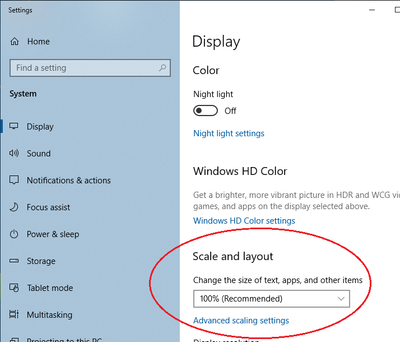

Go to your windows display settings. What is the font scaling? Set it to 100%.
Font scaling: 100%.

Have you investigated the windows fonts scaling?
Message 8 of 9
(3,508 Views)
Apologies for posting previous comments from another account.
Yes, i checked it. the windows font scaling is set to 100%
