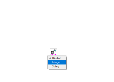

You are reading the file as string....
Instead of that try to read it as integer or double...
