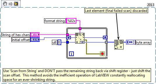

I know this post has been marked answered, but I just can't help myself.  And I do have the greatest respect for Chris' experience.
Mostly in answer to Vijay's several attempts (some flat-out wrong, and the final one close but improvable), I'll attach the following two images (note, only one is a snippet):
Apologies to all and best regards,
Dave

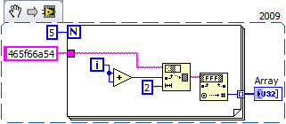

for the fun of it:
Message 20 of 29
