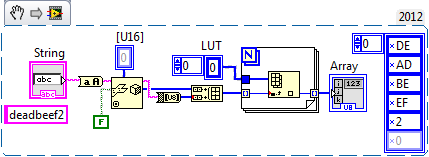

I do not Type Cast in these situations because of the potential for odd lengths, but I do this sometimes:
With a somewhat larger LUT I could remove the To Upper Case function.
Message 25 of 29
(6,392 Views)
Yup, that's another 8x faster (~20ms for a 2M String) 😄
Message 26 of 29
(6,388 Views)
Chris,
I'm stumped as to why the Scan From String performance is so much poorer than the String Subset->Hexadecimal String To Number duo.  I figured SFS to be a pretty direct knockoff of sscanf and so, optimized about as much as possible over the years.  Maybe it's the error output processing?  But then, your for loop example using SFS doesn't wire the error out, so I would expect that handling to be skipped.
Also, when I re-created your SS->HStN example in LV2013SP1, the output of String Subset shows a buffer allocation dot, and floating help doesn't identify it as a (sub)string.  This seems odd to me.  Does this really imply a fresh string allocation every iteration?
At least there is an answer in there about memory allocation for the while loop vs. the for loop.  Not much difference for the 2M character test it seems.
Darin's LUT solution is pretty extraordinary, but again, if the task involves small strings and infrequent invocations, I'd rather avoid the explanation of how it works to a LV newbie...
