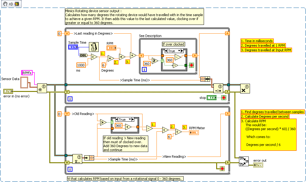

Hi Uddy,
I wrote a small simulator that i think achieves what you are after. I have 2 loops, one that simulates a rotating devices sensor output and another that calculates its RPM.
The first loop simply calculates how many degrees the device would of rotated for a given sample rate and RPM. It then calculates the position of the sensor based on the previous calculation.
The second loop reads the simulated sensor input and based on its previous reading calculates the RPM.
Hope this helps.
Lucither
Message Edited by Lucither on 03-26-2010 10:11 AM
"Everything should be made as simple as possible but no simpler"
Message 9 of 24
(6,936 Views)
Just slightly modified my last VI. I realised that for very fast RPM's and slow sample times the rotational device could actually rotate several times between samples. This VI accomodates for that and still feeds the correct simulated position of the readout:
Message Edited by Lucither on 03-26-2010 10:52 AM
